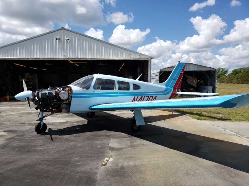

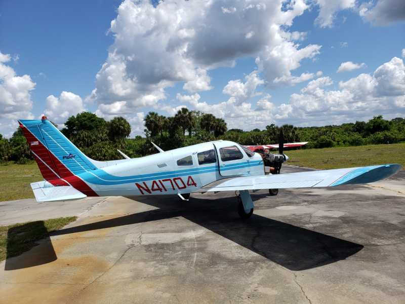

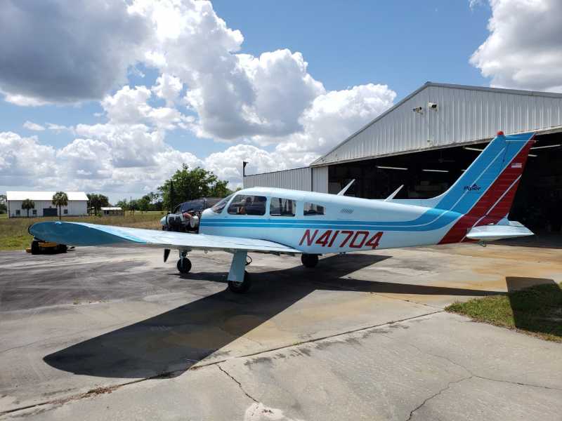

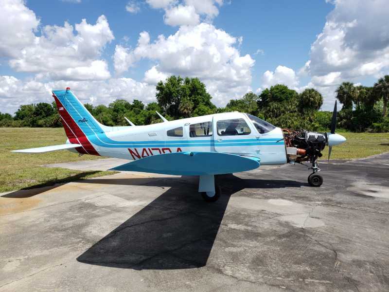

    Last month, I just bought a 1974 Piper Cherokee Arrow II. The Owner died 9 years ago and it has been hangared ever since. I have been going through it and getting it ready to Fly. I am a first time plane buyer. I think that I got a smoking deal on it at $10,000 as I found the receipt for the Garmin 430W that was installed for $12,500 just before the owner passed away. I had an Aircraft mechanic go through it for about 5 hours and he said that it was in great condition. We even jacked it up and cycled the Landing Gear 6 times and all was well. He said most of what I need to Repair/Replace is due to the 9 year Nap that it took. We made a List and I am getting started on it. I just know that I will need help from the Piper Community, so Thank You in Advance! Here are the details:
    N41704
    Serial Number: 28R-7435210
    TT = 4757
    SMOH = 970
    Prop = Hartzell, 0 SMOH, Brand New
    Air Conditioning
    Paint = 8/10
    Interior = 6.5/10
    Suggestions & Findings of Mechanic
    Has Chrome Jugs
    Auto Pilot Working
    All Logs Books, Including Pilots Log Book
    Garmin 430W with Auto Pilot
    Tires and many Hoses need to be Replaced due to Time
    Mags Need to be Rebuilt due to Time
    Spark Plugs/Fluid Change/Filters Changed
    Rear Muffler Needs Replaced
    HVAC Drier/Receiver Missing
    ELT Missing
    Alt Air Cable froze
    Co-Pilot Left Master Cylinder Leaking
    Brake Hoses Old
    One Lower Spar Cap Cover Missing
    Door Hinges need replacing
    Bottom Beakon Inop
    Pitch/Trim Clutch worn out
    Dome Overhead Lights Inop
    Replace old Rapco Vacuum Pump
    Fresh Annual
    It is a real Pale Blue (Imron Baffin Blue) with Light Blue (Imron Big Bad Blue) and Maroon Accents/Trim (Very 1970’s LOL) and a Light Blue/Gray Velvet Interior. I also applied for a change for the N Number – New Number will be N323BG. I look forward to the project, the enjoyment of Piper Ownership and Flying and the Camaraderie.
