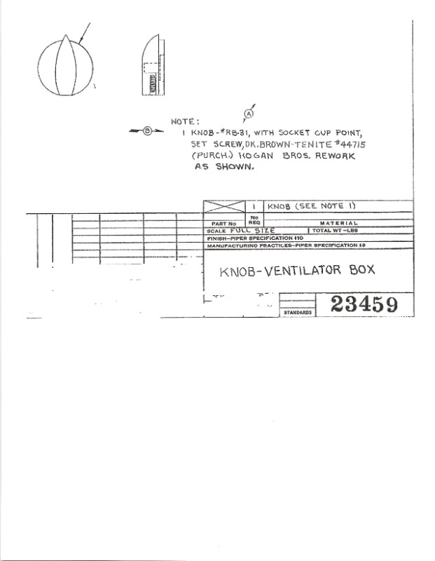

    Kent Dellenbusch on January 22, 2025 at 11:53 am #22971
    Hey James –
    Only one company came up with the part number.  Give Texas Air Salvage a call.
    Best of luck on this one.
    Texas Air Salvage
    802 Hurt Rd
    Bloomburg, TX, 75556
    Phone: +1903-280-9110
    https://www.texasairsalvage.com
    STEVE on January 22, 2025 at 9:14 am #22970
    Hi James and Kent,
    Piper sent me a print of the knob. I never found it in a PA 28 manual, I found it in a PA 24 manual and asked Piper for verification.
    The part number is 23459-00.
    Finding on is a job for Kent, super parts finder!
    I’ve attach the Piper print.
