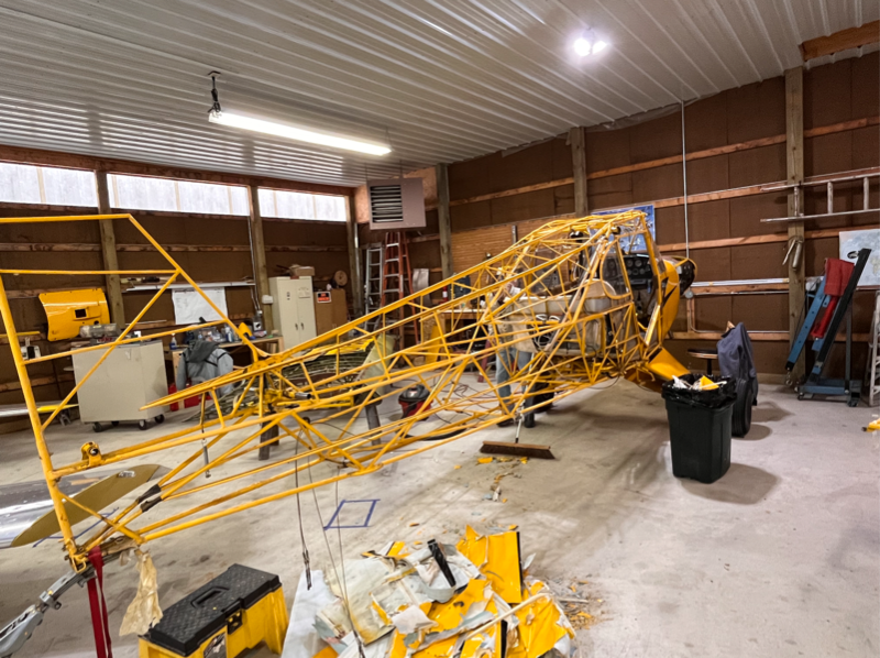

    I just found out about Piper Flyer magazine and subscribed last week.  This is my first post here.  I am a newer pilot, got my PPL ticket in 2020.  I did all of my flight training in a 1948 PA-12, and loved it.  I’d been keeping my eye out for one since then, and a 1947 came up for sale right at our airport a year ago.  It was a good flying airplane, but was going to need attention before long, and was priced fairly to reflect that.  My plan was to fly it for a while, and decide if I wanted to put a lot of time an money into fixing it up, or sell it and move on to something else.  I really love the plane, so am going forward with the fixing part.  It is currently stripped to the bare frame.  Originally the intent was to re-cover and paint, but of course it is snowballing into a much larger (and more expensive) project with each passing day.  There are a lot of upgrades happening, so I am doing a ton of online research.  I am lucky to share a hangar with a retired 40-year airline A&P, so we are able to do a lot of things ourselves.  Paint and fabric are going to be done by a shop with lots of experience with that, hopefully the fuselage will be getting picked up next week.  I’ll probably be back here with more questions as time goes on, please bear with me and forgive my ignorance.
    The floor boards on this plane were pretty trashed.  I removed them, and am replacing with 1/4″ birch plywood.  Any thoughts on what to use to seal and finish the plywood with?  Water resistance is my main concern.  Ideally, I’d seal it with something and then paint it black with something that will hold up to years of traffic.  I’m also open to covering it with something, but I just don’t know what to be looking for.  It previously had a cheap rubber mat covering the old painted plywood.  Any suggestions on what might work best will be greatly appreciated.
    Photo of the plane in it’s current state below.
