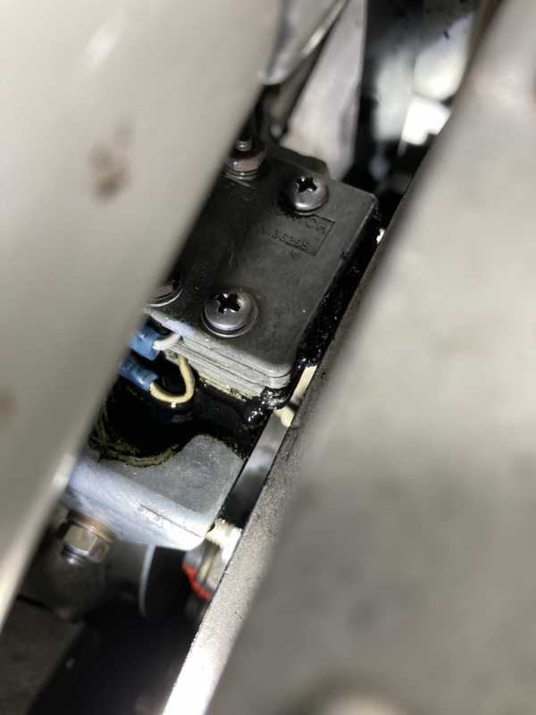

    STEVE on October 3, 2020 at 12:12 pm #20223
    Hi James;
    I checked with Todd, the prop guy at American Propeller and he told me that there’s oil, probably from the engine crankshaft prop seal, but it could be from another spot since, hard as it may be to believe airflow in the engine cowling does swirl despite the speed of the airplane. Todd said that the oil will bond with dirt and dust to turn into an abrasive mixture that will quickly wear the copper band on the slip ring. Cleaning the brushes and brush area with contact cleaner or electrical cleaner should be done before flight to make sure that the slip ring is not worn excessively by the abrasive oil/dust/dirt combo.

    STEVE on September 30, 2020 at 8:05 am #20212
    Hi,
    My troubleshooting brain, plus the TS ing you’ve already done leads me suspect that you have a oil leak past the crankshaft seal. Nothing else accounts for this. You’ve changed brushes, and it only happens on one side so, it has to be something else. The sources of oil up there are the crankshaft oil seal, or the prop.
    Are you seeing any evidence of oil leakage from the prop.
    One simple oil leakage detection method is to clean the front of the engine around the crankshaft as well as possible. Then spray dye leak check detection spray–it’s a white powder–over the area. Fly the airplane and then check for the presence of oil in the area covered by the white spray.
    FWIW, I’ve heard that spray athlete’s foot powder also works.
    I have reached out to my favorite prop shop for ideas. If they have any suggestions, I’ll post them.
    Please keep me abreast of what you’re doing and what you find so I can pass it on if this comes up again.
    james on September 27, 2020 at 5:33 am #20207
    I have a PA34-220T. (Seneca III) and one of the hot prop brushes was worn out and was replaced 10 months ago. After a new brush was installed it started making some sort of goop around the brush and then throwing it onto the front cowling. It was cleaned and checked 3 times and all looked good including the adjustment. My tech then replace the bottom brush. Same thing happened. We then replaced both again and adjusted. Same issue. Last week they called Maxwell and sent pictures and they replied they have not seen this before. They have been in contact with our local rebuilding engine shop (Bolduc Aviation) and they have not seen or heard of that also. After months of going through this i believe it is happening while going through rain. the other engine does not have any issues. It has been cleaned and adjusted many times and the new brushes, with now about 150 hours on it still look new. See pictures below. E96B902A-675F-4081-AFD5-083C2E889EDB_1_105_c.jpeg
    Any help would be greatly appreciated.
