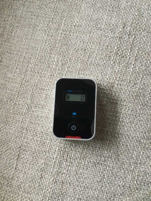

    Good call! Just bought it from Amazon. Update on my Forensics CO Detector. The picture looks like it has a blue backlighting in the indicator. It DOES NOT. Almost impossible to view without a flashlight.

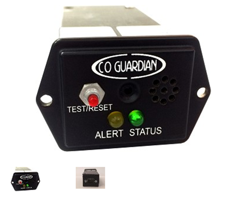

    For certified installed units, our supporter Guardian Avionics has this one. https://www.guardianavionics.com/guardian-aero-451-101-panel-co-detector-certified-norsee
