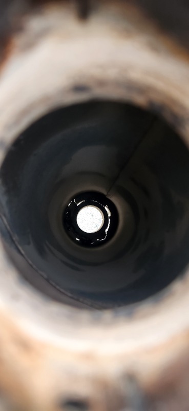

    Joel on February 21, 2024 at 12:12 am #22407
    Here’s a photo looking through the muffler to the opposite end; you can see the cracking and missing pieces.

    Joel on February 21, 2024 at 12:10 am #22405
    Thank you both very much for the prompt replies!  After speaking with my A&P I took the muffler off over the weekend and shipped it out to Aerospace Welding Inc. in Minnesota (they responded the quickest with an estimate and instructions).  I tried to post a photo of the muffler in this reply, the entire end had blown out on the side that feeds the carb heat shroud.  This could have gone from a nuisance (CO warning in my ear) to extremely bad very quickly.  Lesson of the day is… pay attention to warning signs!
    Once I get my plane back in one piece, I’m going to hunt down Paul Groyko and see what ideas he might have for the future (I know the single exhaust tends to be a weak point).
