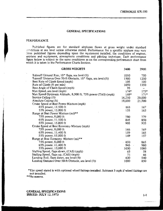

    Don’t get me wrong, I love a good turbo, but for everyday flying in the flatlands, you will be just fine with a normally aspirated PA-32, especially the 300 hp models. My answer would be different if you were in, say, Denver, and planned to be going back and forth across the Rockies frequently.
    While the kids are small, you’ll be operating well below its MTOW, probably by several hundred pounds. And even when you start schlepping teenagers, mountain bikes, camping gear, etc, you’ll still have a hard time reaching MTOW in the early PA-32s.
    That low operating weight means performance. Check out the attached spec sheet from a 1973 PA-32-300. The empty weight for this model is around 1900 pounds (the book says 1864). If you, your wife, and your kids (currently) weigh 500 pounds, and then you bring full fuel (84 gallons = 504 pounds), you’ll be at the 2900 number used in the performance chart.
    1350 fpm climb at 2900 pounds is nothing to sneeze at, and those takeoff and landing distances are pretty short. And should you want to bring a few friends, you’d still have 500 pounds of useful load!
    The one downside I see to a PA-32 is that the IO-540 is a bit of a fuel hog. My buddy with a PA-32-300 says he plans for 15 gph. The Owner’s Manual says 16 gph at 75% cruise power. You can go a little slower and burn less; 12.7 gph at 60% power. If you plan to use the airplane mostly for family trips, the high fuel burn is probably worth it for the extra capability.If you find yourself flying it solo a lot, with one or two trips with the family over the course of the year, that 15-ish gph burn may be harder to justify.
    For what it’s worth, a normally-aspirated Cessna 182 drinks 14 gph at 75%, 11 gph at 60%. A 180 hp airplane like Steve’s Comanche 180 (or my former Cherokee 180) will do about 10/8 gph, respectively.
