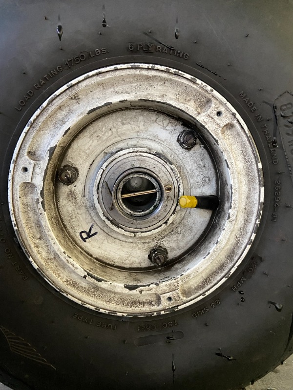

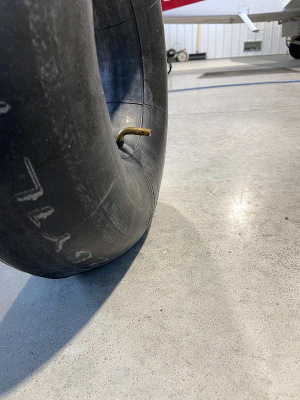

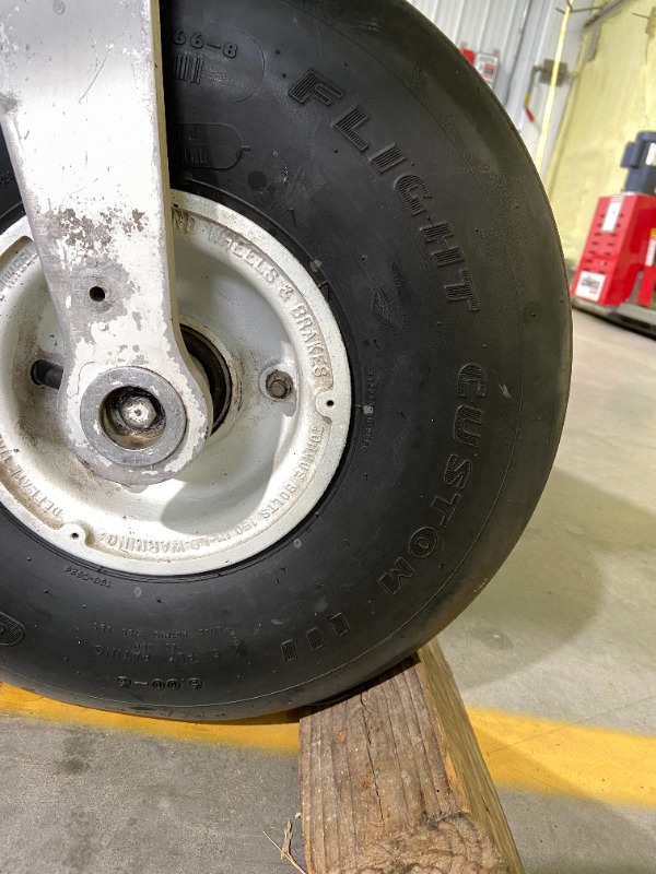

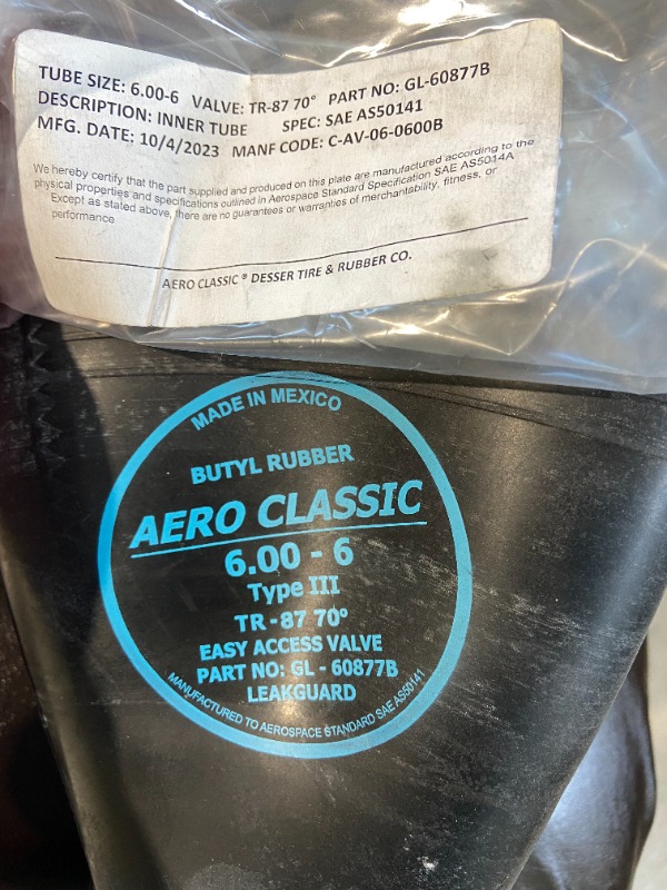

    Desser Aerospace responded with this description. “The Aero Classic GL-60877B (TR-87 70 DEG) and GL-60879B (TR-87 90 DEG) are both bent short (1.5″) valve stems”. The TR-87 90 DEG was out of stock but I did find a couple other folks stating the 70 DEG is a good solution so I ordered the TR-87 70 DEG tubes; see pre-installed images. The 70 DEG valve stem actually protrudes from the tube off center at an angle so the ‘effective’ angle is about 90 DEG or roughly parallel with the axle. The short valve stem should clear the nose fork and its bend angle will point it toward the fairing access door. If main gear hub caps are used without fairing (I use these when fairing are removed), I’m not certain the 70 DEG bent valve clear the hub cap; in this case the GL-6020B TR-20 straight stem tube may have to be used which works fine in this application.

    I did find an Aero Classic 6.00 x 6 tube with a 70 degree angle stem on the Desser Tire website under part number GL-60877B. When you type that number into the search window on the Desser site a picture will show the stem. This tire is also for sale from Aircraft Spruce and Specialty under part number is 06-03303. Cost is $95.

    Brendan O’Rourke on January 7, 2024 at 2:43 pm #22332
