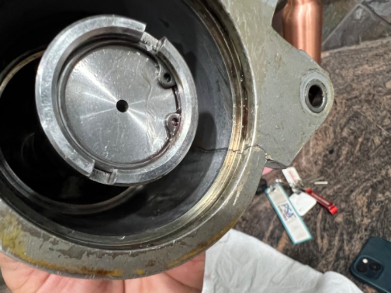

    It’s quite possible that that crack was caused by an over turn of the nose LG by the ground crew when towing your airplane. Usually the damage from an over turn is to shear off the “stop” you can see where the crack starts at the outside of the strut housing.
    I would like to feature the picture you posted in one of my Piper Q&A columns but the photo is much too small.

    Will Starnes on June 1, 2024 at 9:29 pm #22552
    Thanks Steve. Contacted them. They will only repair the “nubs” for the steering hub. They said any crack in the tube makes it unserviceable and they cannot repair it.
    I found one at Dallas air salvage.
    STEVE on June 1, 2024 at 9:17 pm #22550
    Hi Will,
    It appears as though http://www.precision-welding.com has FAA approval to do weld repairs on the 21707-000.
    I’m not sure they can weld the crack, but it’s worth a phone call to find out!
    Will Starnes on May 30, 2024 at 7:30 pm #22547
     IMG_6473.jpegLooking for SERVICABLE Nose gear assemble # 21715-04 or the Tube Assembly # 21707-00.  mine has cracked and has my plane down.
