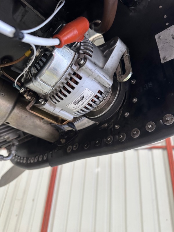

    Hi Dale,
    I replaced the 50 amp generator on my Piper Comanche with a Plane Power SAL 12-70 alternator in 2014. The installation kit fit perfectly. Although I don’t fly a lot, it’s been fault free for 320 hours since I installed it.
    My Comanche has a Lycoming O-360 4 cylinder engine.
    Not only has the alternator been fault free; it has 20 more amps output capacity than the generator I removed; it’s also 8 pounds lighter.
