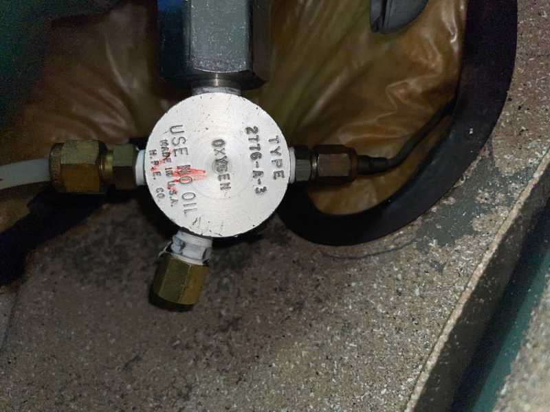

    STEVE on October 17, 2022 at 1:29 pm #21633
    Hi Harry,
    That wasn’t helpful.
    Try Precise Flight–it sells O2 systems. http://www.preciseflight.com
    and Mountain High Oxygen at http://www.mhoxygen.com
    Harry Gaines on October 12, 2022 at 12:52 pm #21616
    This is AEROX’s response: I sent them a photo of regulator w/part number.
    Thanks for sending this along.
    Although I don’t have an immediate solution to this, we have started the process which will likely be in several months.
    I have saved your email to the engineering folder so we can keep track of who needed help.
    Please feel free to reach out anytime for an update.
    Best Regards,
    STEVE on October 12, 2022 at 11:40 am #21615
    Hi Harry,
    Please excuse my slow response.
    Sky OX was purchased by Aero OX. The website there is www. aerox.com.
    Please ask whether it can overhaul your regulator. If not, ask for the compatible replacement regulator.
    The contact is customerservice@aerox.com.
    Again, I’m sorry for my slow response.
    Harry Gaines on October 5, 2022 at 11:29 pm #21606
    My O2 (installed system) regulator part #2776-A-3 is leaking. It fits a 50 cu ft tank. Does anyone have a suggestion on where I can get a replacement or a cross reference chart?
