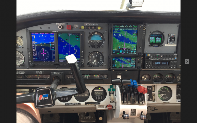

    Jamie Szendrey on September 11, 2021 at 5:05 pm #20940
    I have them on my Seneca II. I highly recommend them. They work well. In addition to increasing critical Altitude, they also help remove any throttle split at higher alt due to fixed wastegate settings. My engines are about 800 hrs over TBO. I like to run them at min RPM for the conditions. I can get 75% power at FL220 and 2300RPM. Best you’ll do with fixed waste gates @2300RPM is about 12K. I also run mine lean of peak. I burn about 19 GPH total. I lose a little power, but the pay off is worth it. I lose about 7 KIAS vs running rich of peak and I’m burning about 5 GPH less. With a 123 Gal tank I can fly 200NM farther, and only lose about 5 min on a 4:15 hour leg. I’ve only had one maintenance issue with one. The mount cracked. I pulled it and sent it back to them and they replaced the mount.
