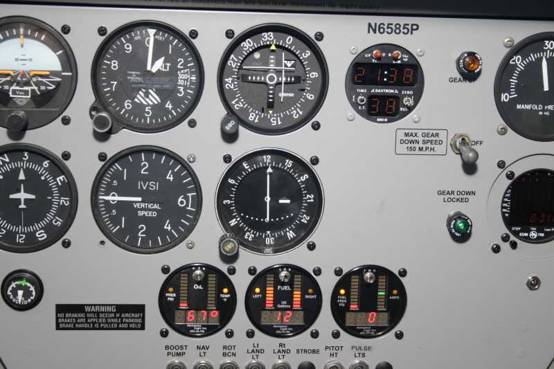

    A few years ago I removed the 50 year old gage cluster from my Comanche and replaced all the gauges–fuel pressure, oil pressure and temperature, amps, and left and right fuel quantity–with 3 2 1/4 inch AeroSpace Logic gages. The Aerospace Logic gages are STC approved for the replacement of the primary gages and so far are working great.
    If you are completely re doing your panel both Electronics International and JP Instruments sell Engine management panels that include these gages.
    It may be easier and a lot quicker to purchase already approved by STC gages than to get your local FAA office to approve a data package such as the one for the Mitchell gages.

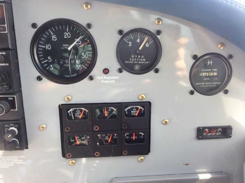

    Here is a photo of the gauges.
    My mechanic can supply all of the docs to take to your FSDO for $550. The fuel gauges are defined as primary fuel gauges.
    Any questions, contact me.
    The new 6 pack is slightly larger than the originals – about 1/4″.
    I have had them in now for a year and they are great.

    I had the same issue, and my shop successfully obtained a 377 for using Mitchel gauges. 🙂
    They look and work great and use a footprint just slightly larger than the originals and are available with lighting.
