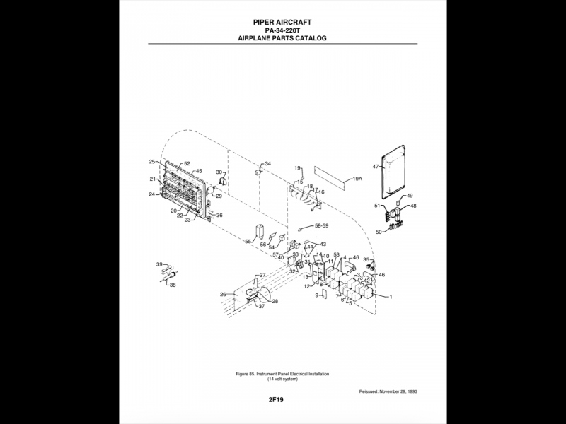

    George Henning on November 7, 2020 at 7:10 pm #20310
    Thanks Steve!
    Yes, I will review your wiring diagram with my A&P!
    We are looking at that very “potentiometer” as it’s called in the Piper Parts Catalog.
    Attached is a copy of those pages if anyone else has a similar concern!
    I’ll let you know!
    Thanks again!
    George
    CLE

    STEVE on November 6, 2020 at 9:40 am #20307
    I got the wiring circuit for the panel lights. There is a transistor in each dimmer; I don’t have the spec for the resistor but if there’s an electronics expert around –may be beyond the typical avionics shop since most don’t do bench work or repairs any more–he/she may be able and willing to replace the transistors, which are probably the problem
    If not, I recommend replacing the faulty dimmer with one of the Seaton industries dimmers I mentioned in an earlier post.
    Let me know what your find.
