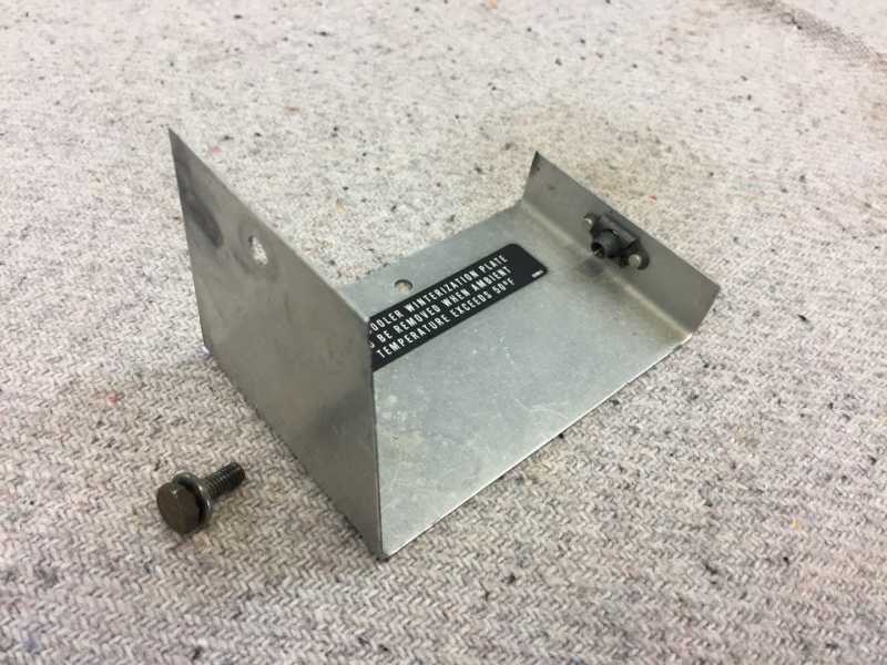

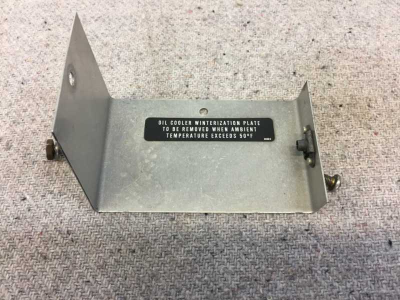

    One of our Canadian Seneca owners asked me to post this, he had trouble uploading this photos:
    Hi George,
    I too am the lucky owner/pilot of a Seneca III for over 30 years and 3500
    hours.
    The pictures I have posted show the ‘Factory oil restrictor plate’ that came
    with the airplane, and fits in the ‘outboard section’ of the oil cooler.
    These TSIO360 engines run fairly cool, so in order to achieve a minimum 180F
    oil temp. I had a second restrictor plate fabricated out of sheet metal
    (very easy) for the middle section, which for most of the year is still not
    enough restriction, so you will also note I used a metallic tape to restrict
    the third section. Basically the oil cooler is almost 100% restricted as the
    third photo shows, and this works even on warm summer days as I have not
    seen oil temps over 210 in climb. If I ever fly to Florida again, I will
    simply peel off the tape.
    I am looking at your photos, so the factory plate fits on that first section
    of the top of the oil cooler which you will clearly see on my third photo,
    with the small bolt that is in place to the left, plus the additional screw
    you see on my middle picture, to secure the plate. When you add the middle
    plate (which as noted you must do to get oil temp up to min. 180F to burn
    off the moisture), you can use the factory bolt on front of plate. I did not
    even secure the back of the middle plate.
    All the best,
    David
    Seneca C-FJMM

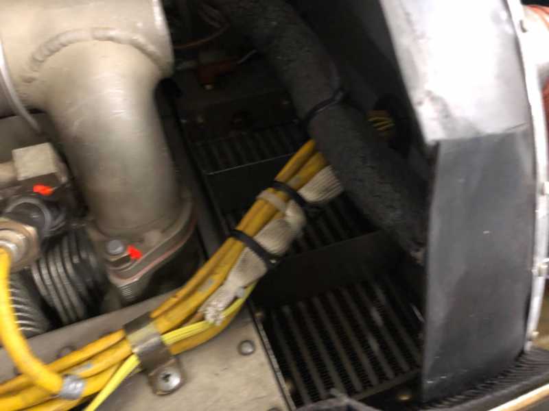

    OK, I got this new-to-me 1981 Seneca III and it’s getting to be that time of year up here in Northern Ohio and I went to install the Piper Winterization Kit on both engines…
    The Maintenance Manual has been very helpful in pointing out other procedures but the installation of these Oil Cooler Covers seem lacking.
    Even the Parts Catalog don’t really highlight these parts very well. I’ve found the “ blow-up” pictures to be helpful.
    The MM says to “install the plate in the inlet plenum of the oil cooler”… ??
    Now, I’m familiar with the PA-28 type of Winterization Kits, but the Seneca is totally different.
    Any help would be appreciated!
    Where is the “plenum chamber” and how is the plate installed??
    Below are the pictures I took when I pulled off the side cowling to get to the oil cooler.
    Thanks in advance!
