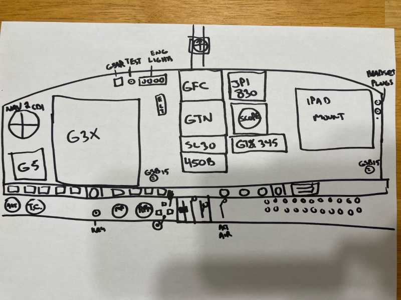

    Matt Schloss on December 9, 2021 at 12:00 pm #21114
    Jeff,
    This will be a nice looking panel when it is done and I think I speak for everyone when I say I look forward to seeing the finished product. Let us know if you have any other Questions!
    -Levi Vickers

    JEFF BAXLEY on December 9, 2021 at 11:38 am #21113
    Yes, the panel is already in pieces as we speak. I approved a rough layout and the design was sent to the panel maker and they will be the ultimate arbiter of what can go where.
    I’ll post up a final layout once we get it back from the panel designer.
    Matt Schloss on December 9, 2021 at 5:49 am #21111
    Jeff,
    That is a good lay out, I noticed you had a CDI in the top left for the SL 30. You would not need that CDI. You can display the GTN and SL30 Nav info on the G3X. Do you have an install facility picked out for this project?

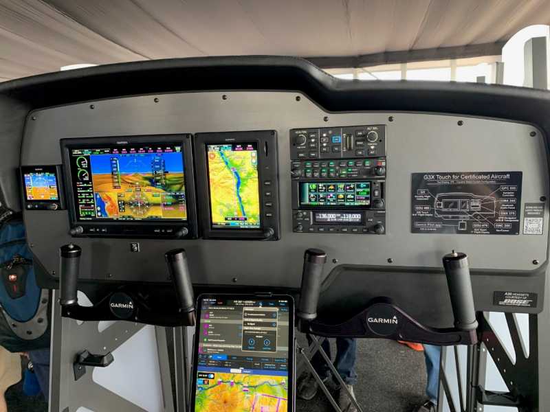

    Vincent Rispone on August 8, 2021 at 4:17 pm #20833
    I was considering the G3X and JPI but I’m now considering using the G3X engine monitoring after a flight in an Arrow that did the same – I liked the seeing the gauges on the screen right in front of me – have you considered going w/ the G3X engine monitoring in lieu of the JPI?
    I saw this at Oshkosh in the Garmin tent – it shows some of the G3X 10″ display capabilities.

    JEFF BAXLEY on August 5, 2021 at 11:41 am #20829
    New panel on my PA32RT-300T being designed. Here is my rough drawing of what I think it should be. Thoughts from the crew on this layout?
