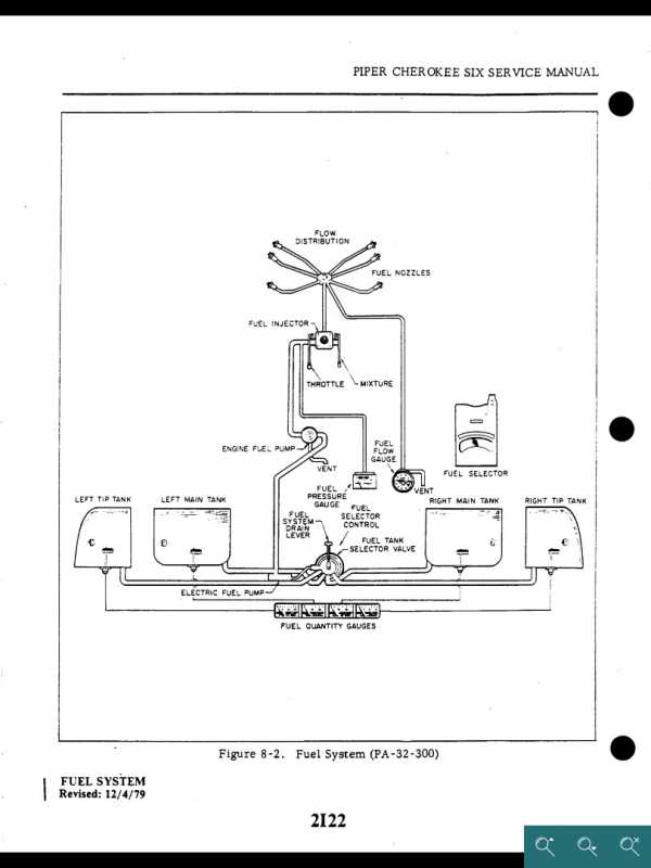

    STEVE on October 28, 2020 at 9:29 am #20290
    The “fuel flow” gauge is actually a fuel pressure gauge calibrated in gallons.
    The electric pump pressure is controlled by a relief valve in the body of the pump, as I remember it.
    Joseph Signorino on October 26, 2020 at 5:19 pm #20287
    As I wait for the bump rebuild to be complete I was thinking about the electric pump and how it regulates the pressure. On some race engines I have had with electric pumps installed the pump stopped when the pressure built up with the engine off. The pump on the Lance runs continuously once energized. The Lance has fuel flow gauge but no fuel pressure so is it possible the electric pump is producing too much pressure? Any idea how they regulate the pressure?
    Brandon Dorsett on October 25, 2020 at 7:15 am #20284
    Good luck. Still awaiting results as well on my pump. It’s currently in Tulsa. Attached is a diagram of my system I was referencing earlier. FB5D20C9-513A-49A4-AE6A-D0D047E9F64B.jpeg
