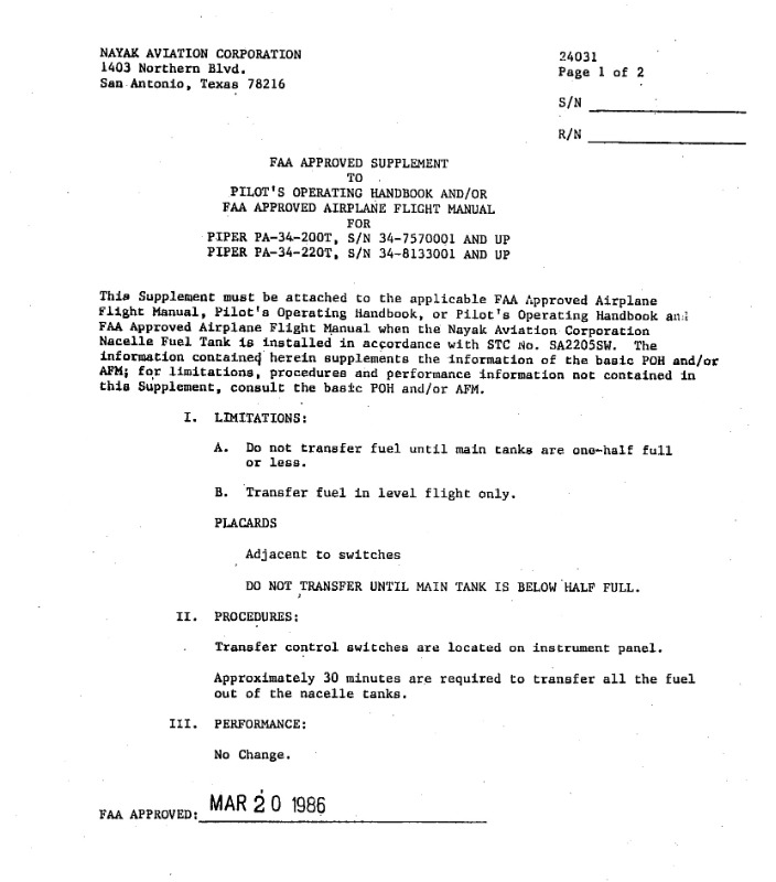

    Dale on April 26, 2023 at 12:58 pm #21939
    Our shop has received the aux tanks from Griggs.  We are currently awaiting install.
    Griggs was were very responsive in the admin / questions phase – even weekends and after hours, timely in delivery, and honest about all the costs.  No complaints so far.
    We received the attached files in the purchase process.  So no install or flight information yet.  Filled, the tanks amount to ~180lbs, or about a person.  (Install weight not known yet)  This would seemingly provide one more hour of flight time at normal cruise fuel flow.
    The attached factory-provided install pictures are somewhat difficult to view because they are rotated 90° L&R, but they provide at least some idea.
    • PA34-AuxTank-FactoryInstallPics.pdf
    • PA34-AuxTankInstallInstructions.pdf
