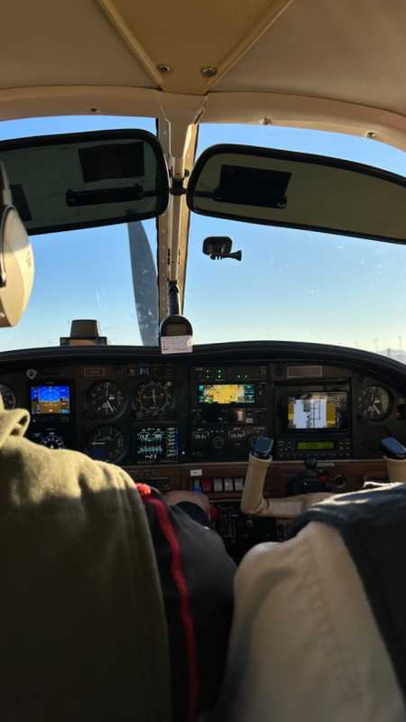

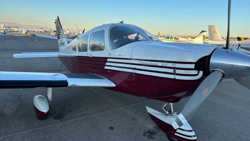

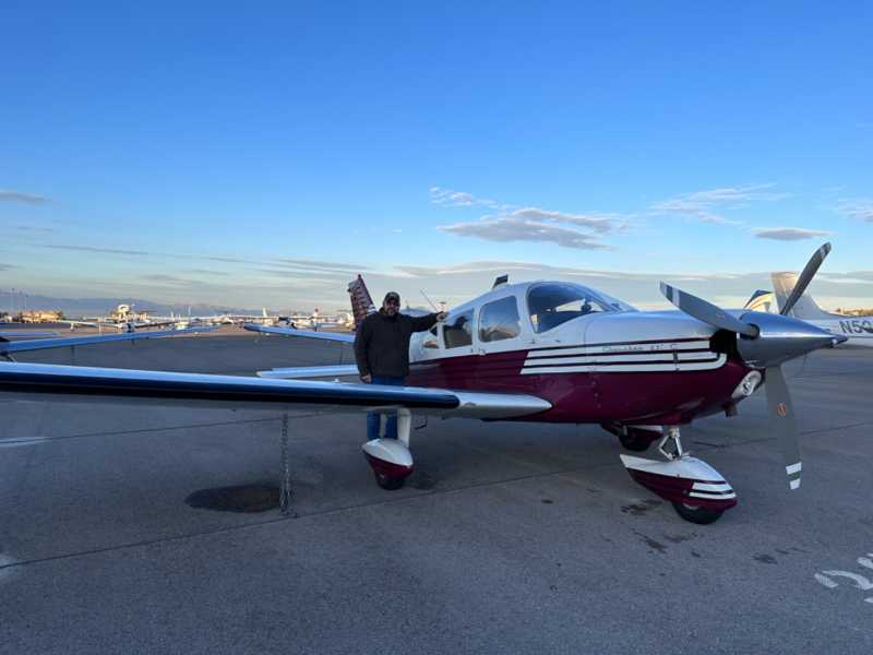

    You have a good looking, well equipped airplane based on the pictures.

    Hello! New member here in Las Vegas. Proud owner of N365NG a 1968 Cherokee 235 C.
