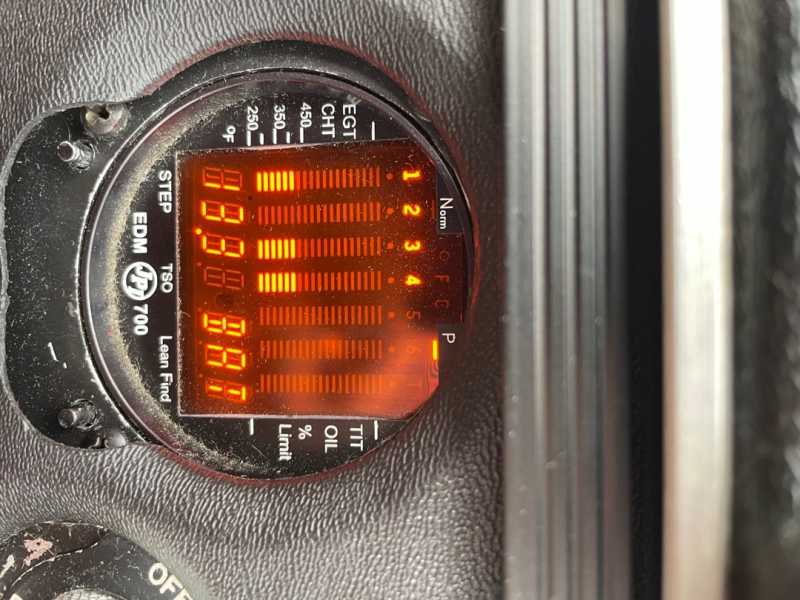

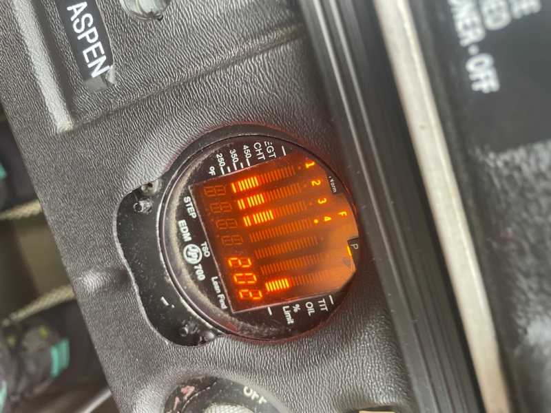

    For those who are curious the issue still persists after having 4 mechanics look over the engine’s ignition and fuel system. Both magneto’s have been replaced. The last time the misfiring occurred in cruise was at 11,000′ and it lasted for about 3 to 4 minuets (very unnerving in IMC over terrain in New Mexico!). When this was going on I snapped a picture of the JPI engine monitor and it showed cyl #4 completely dead/cold. The engine then fixed itself while I was diverting- it came back and ran smoothly before landing. Mechanics I spoke with checked all sparks were firing and they re-gapped the spark plugs. On start up about 8 flight hours later the misfiring was back, only when idling, this time showing cyl #2 dead/cold.
    Everyone at this point thinks that water is getting into the fuel system. The right hand take cap gasket is very thin and its possible water gets in on the ground or in flight. Most of these occurrences have been on the right tank, except the one at idle on start up. I always sump my fuel- only three places on this arrow, and have never noticed water. We are going to replace both tank cap gaskets and go from there.
    Is there anywhere else in the fuel system water can enter? If it isn’t water the other possibility is the diaphragm in the fuel distributor is going bad?
