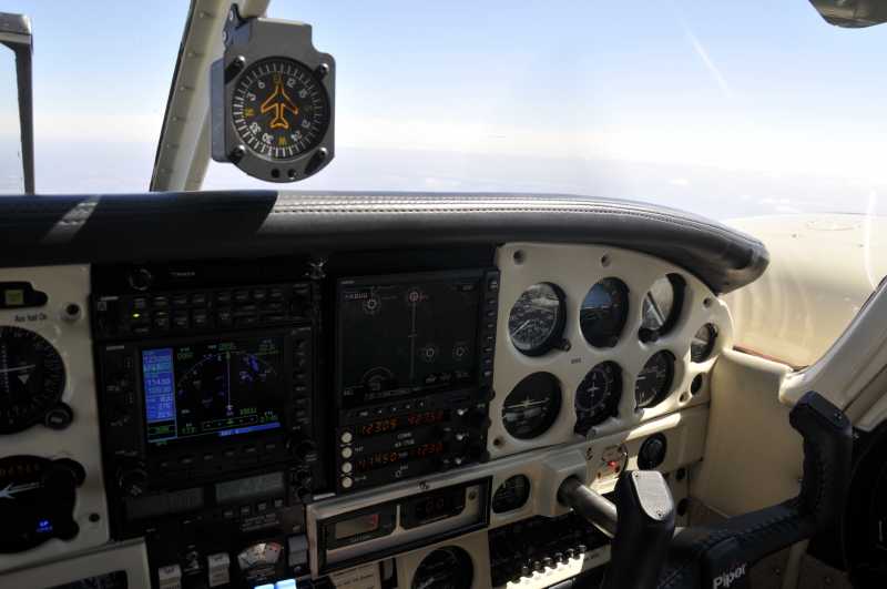

    HI Dave,
    I have a 1977 Seneca 2 that had yokes similar to those in your description. I sent my yokes to Aero Comfort (www.aerocomfort.com) and they recovered mine in leather. I’ve attached a picture (sorry, not the greatest) to assist you.
