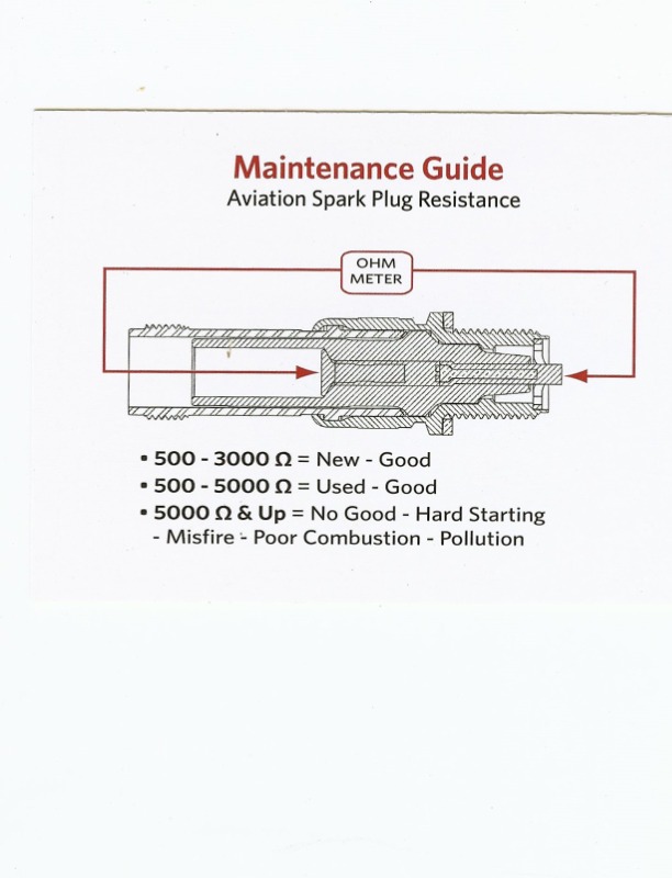

    I suggest you do the following tests on each spark plug. Measure the electrical resistance from the contact button down in the barrel–where the spark plug contact hits; and the electrode at the firing end. If the electrical resistance is more than 5000 ohms, replace the spark plug.

    I have attached an article I wrote that addresses Lycoming valve guide wear, a Lycoming service bulletin and a picture of the spark plug resistance check.
