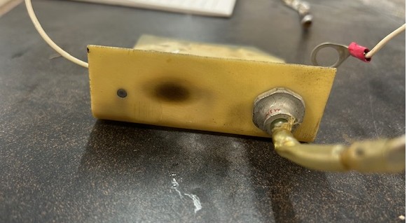

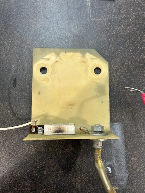

    Guaranteed that resistor was starting to glow orange due to high load resistance.

    We finally got a chance to dig in to our annoying snag this past week.  Decision was made to remove the diode assembly because of this:
    Measured the resistance at 12 Kilo ohms vs 4.7 ohms printed on the side.  Diode was measured and function correctly.  I’ll be sending this info to Piper because of the potential safety hazard this could have caused.  Being from Canada, I am going to report it through a Safety Difficulty Reporting system.
    *Kicker*  owner went flying today without this diode assembly installed(its only needed for external power starts in case of a dead battery).  3 or 4 circuit later, alternator tripped off again when they checked the Engine display system.

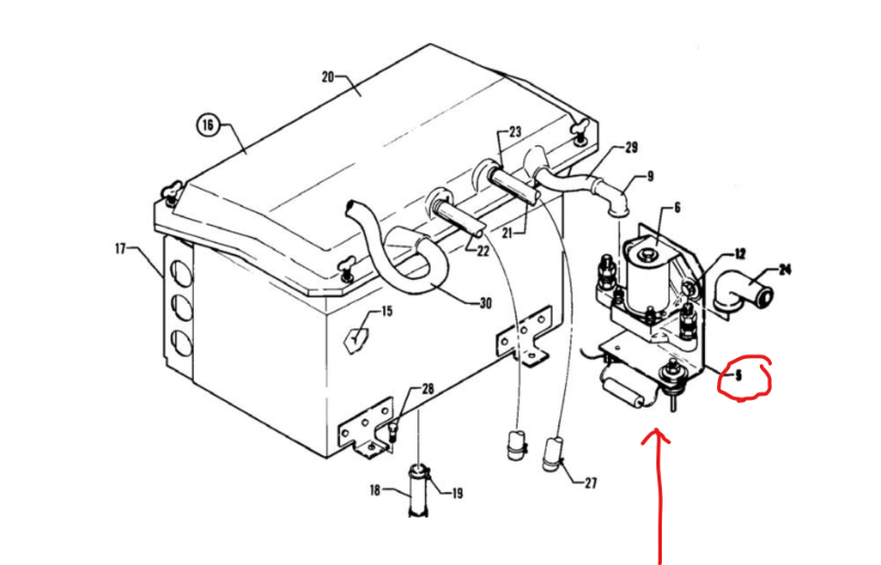

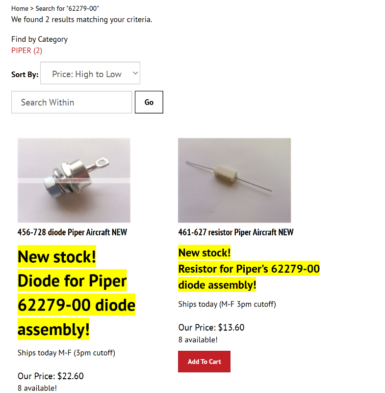

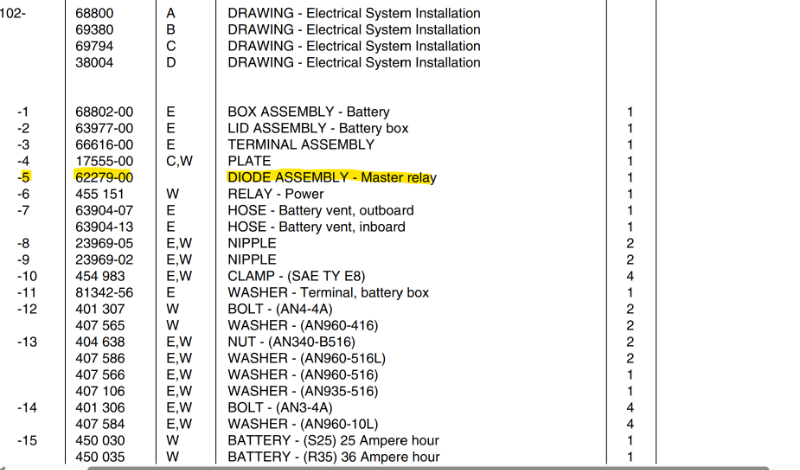

    Thanks again!  I was going to do the same on my end.  Everyone else that I have mentioned this to are equally as stumped.  I was able to get part info and availability.  See following snips:
    Looks like you can individual source a resistor and diode that form the Alternator Power Relay.  Keep me posted if you here anything back from Florida.

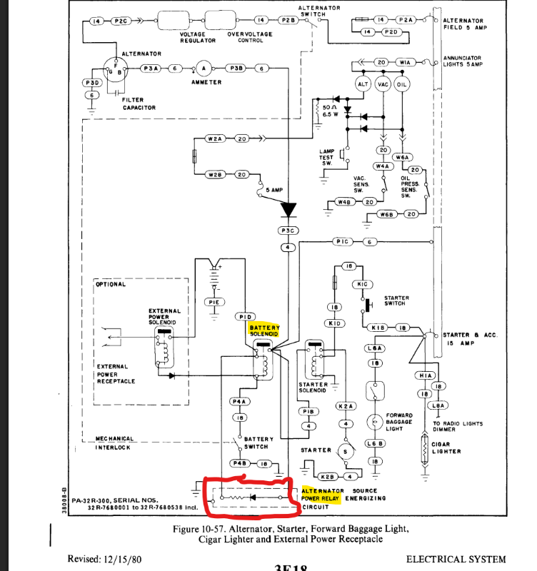

    I suspect the problem centers around alternator power relay circuit.
    I can’t find any particulars or part numbers of that circuit in the parts catalogs.
    I’ve reached out to Piper and awaiting its response.

    I believe what you’re describing as a capacitor is really a resistor that’s part of the Alt Power Relay circuit.
