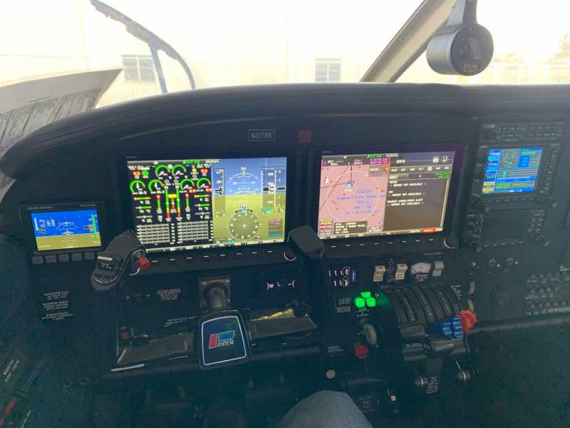

    That surprises me but folks at Dynon would know. I’m attempting to load the photo again.

    Aaron Ramert on May 11, 2022 at 8:00 pm #21392
    I think that the Dynon engine monitors are certified. I have seen a Seneca II with the original engine instruments removed and the Dynon Skyview HDX installed. If the picture doesn’t come through it is N21788 and the owner told me that it was done by Saint Aviation in FL. I would call Dynon and ask them directly. I purchased a Seneca III earlier this year. My plan to was to do a Dynon panel but this has a decent Garmin panel and the autopilot does okay, so I won’t do anything for now.
