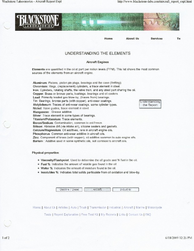

    I have attached a guideline from one of the most well known oil sample analysis labs showing where various metal originate.
    I’m interested in what Continental told you.
