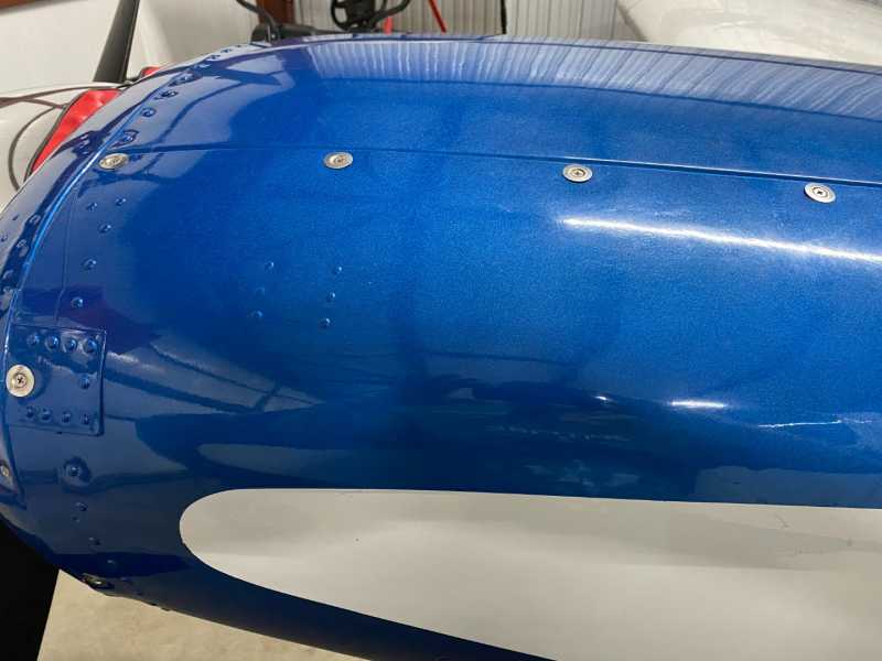

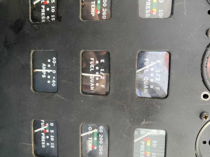

    So…. Since I couldn’t go to the fly-in at Triple Tree I got to work with my mechanic on the plane today. We got the final parts put in for the nacelle screws as there had been a few that needed attention. Then we put our attention on the fuel gauge switch. After adjusting it we think we have cured the “flaky” gauge. The microswitch needed adjustment. Also, the right fuel tank selector lever was very stiff. After playing with it we decided it was the cable itself that was dragging. So we lubricated it and worked it a bit. So far that seems to help so we will wait and see how it goes for now but it looks like that is taken care of. HOWEVER, in digging into the underneath of the plane we found the aileron cables are starting to touch on the sheet metal that forms the rear of the footwell. No issue yet but that is not something to ignore. So that will get attention very soon. I am always careful to do my control checks and I will be extra attentive to them for now. But I don’t see any issue right now.
    We got in a few trips around the pattern just “because” and the plane is flying well. We have moved to the “optional” part of improvement for 89P and we now get to do more “fun” stuff. I have quite a bit planned yet so hopefully we will get to do all that in the coming months.

    On landing there was a bit of northerly wind and I easily made the first turnoff. I was ready to depart and as I was getting ready to take the runway I saw the left main fuel tank gauge was on empty. I knew it should have plenty of fuel but decided I should check it out on the ground, not in the air. So I told tower I had a low fuel indication and they had me taxi down the runway to clear (two Navy trainer jets behind me!) and I went to Signature to get fuel. Of course it was just a “flaky” gauge. So we need to check the switch on that as it has to switch from MAIN to AUX indications with the fuel lever and I think that is where the issue is. I can push the lever and get the needle to “bounce”.

    Once the brake was taken care of we got into replacing the fasteners on the left engine. We got it almost finished. Just a few that need a different size washer and one that will need repair. Otherwise it is finished. We did find two minor issues that we fixed while we were in there. A cooling blast tube for the magneto was loose so it was riveted back and we found a missing rivet on a patch on the firewall so it was replaced as well. Also, we noted areas in the engine cooling baffles that will need to be fixed on the annual.

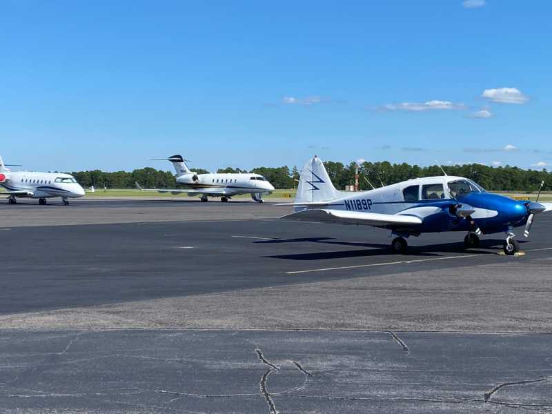

    Picture is 89P sitting on ramp with the “big iron” behind her at KSOP.
    Had time and good enough weather to fly a bit. We had not gone to Pinehurst yet so that became a “quick trip” destination. Overall it went well and while I had planned to fly south of the Class B airspace around KCLT we got cleared by ATC to fly through the Class B at 8500′. That really helped to shorten the trip which was much appreciated as we had about a 10 kt headwind.
