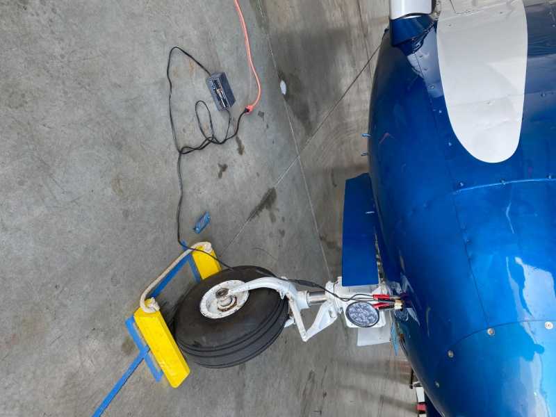

    Eric Parks on September 9, 2021 at 7:14 pm #20938
    LED lights work great. They are bright even in full sunlight.

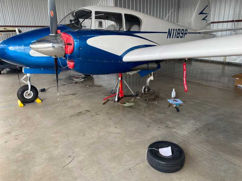

    Eric Parks on August 30, 2021 at 5:37 pm #20921
    The last time I taxied the Apache the right brake “gave out”. Yup, while taking it to the hangar. So apparently giving the left brake all the attention only made the right brake jealous. So today was the day to fix that. Of course, since we had so MUCH experience in doing the left brake this was going to be a breeze.
    I got to the hangar and my mechanic buddy had already gotten started and had the new O-rings in the caliper. So all we needed to do was use his handy “pump thing” to bleed the brakes and we would be good to go. Of course…. NOT.
    He began to bleed the brakes and I also worked the brake pedal from the cockpit. We were getting NOTHING. Finally as we got more frustrated the hand pump just broke in his hands. Cheap plastic. So now we are back to the old way to bleed the brakes but getting nothing. We worked for quite a while. Finally he told me to pump it 10 times and I felt the pressure build! I told him it was working… until number 8 when I felt it go flat again. What?
    However, this time he saw where the issue was. He removed a (T-fitting?) and put three tiny O-rings into it. When he put it back in we were finally able to pump up the brakes and got everything working again. So I guess we will get that additional part re-built on the annual for the other side. At least we are back to flying. I tested the brakes with a slow taxi, a fast “taxi” down the runway and finally I did 3 landings with everything working properly. Now it’s time to put some flight time on it!

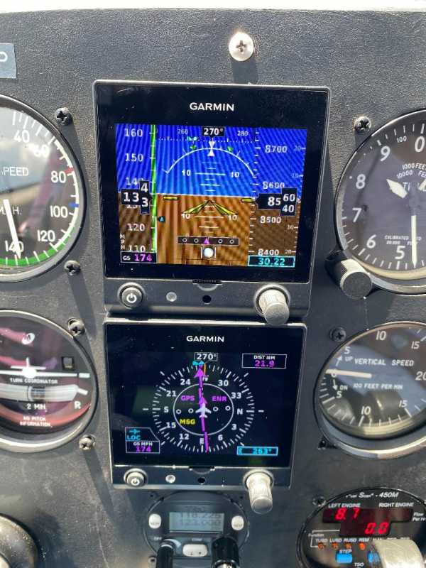

    Today was a humbling experience for me and I didn’t even fly! Last flight I noticed on taxi in that my fuel gauge on the left tank was reading lower than it should. So I made a mental note to check it next time to see if we needed to fix it. I really wasn’t surprised since the Apache is so old you can’t expect the gauges to be correct all the time.
    The past few times I flew the plane I also had noticed that the Garmin G5 that is my Attitude Indicator was not coming up automatically when the Master Switch was turned on and I assumed it was a software or connection issue. However, all I had to do was press and hold the power button and it would power up and work fine. After a couple times of this I did some research online and found out that there were software updates available and some pilots had experienced start up issues that the new software fixed. So I got a micro SD card and downloaded the upgrade.
    Today I first went out and did the upgrade. That went very well and quickly I had both G5 units updated from version 5.5 to 6.82. I was feeling pretty good. I then decided to check out my fuel gauge issue and would also check the G5’s when taxiing it over to the pumps. I first took pics of the fuel gauges on both Main and Aux. On taxi over I realized my G5 was still not working correctly so the new software update did not fix it. When I pumped the fuel I wrote down the gallon amount on the pump after each tank was filled. This way I could keep track of how much went into each tank. Wow! There was a huge difference in the Mains. The Aux tanks were within .3 gallon of each other (16.6 vs 16.9) in a 18 gallon tank. But the Mains were way different, 27.7 gallons in the left Main and 7.9 in the right in 36 gallon tanks. So that explained the low fuel gauge on the left, it was showing low because the tank WAS low!
    However, this really worried me. I could only figure that the Crossfeed valve was leaking under pressure from the AUX pumps. The AUX pumps are typically used for takeoff and landing (low altitude) and OFF for cruise. I had left them on accidentally when flying the other day at cruise and had done a lot of pattern work with them on so I decided that must be the reason for the difference in fuel burn. The Crossfeed valve must be leaking under pressure from the AUX pumps.
    After getting the plane off the fuel station I called my mechanic buddy who was on his way out to the airport by then for some work on my plane. I told him of the new issues and how I was disappointed in the plane having more issues. He asked me if the circuit breaker was popped on the G5. I had no idea…
    Going back out to the plane I crawled under the panel to check the breaker (it’s in a really bad spot to see it!) and there it was… A popped breaker. I reset it and everything worked just fine! Somehow the breaker either popped or was accidentally knocked open and unless you get under that panel you can’t see it. At least the G5 was now fixed!
    My buddy got to the airport and we started working through the Fuel Crossfeed issue. I was explaining to him what I had seen and used the pictures I took of the gauges before and after fueling. Then I showed him the fuel panel and how I switched tanks. Then I showed him the Crossfeed…. Oops! It was ON. I was sure it had been OFF but there it was big as life. I told him I found my Crossfeed valve issue. I had it ON when it should be Off. Well, that explained why the fuel burn was uneven! So another problem fixed. Sigh….

    Pretty easy to update G5
    In process
    Updated!
    Gee, that doesn’t look right!
