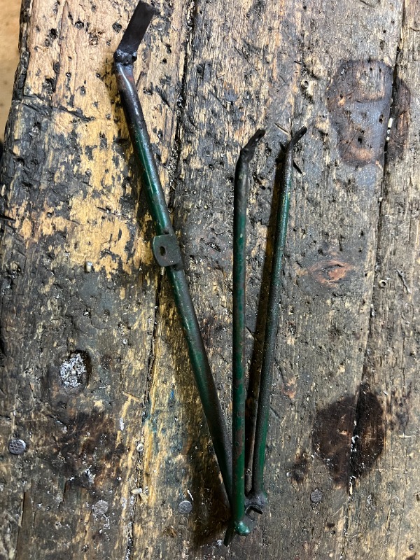

    We got the prop governor looked at by H&H Propeller and they reported back that the unit just needed adjustment. So good news! No real repair needed and they set it up properly (pun intended!). It has been reinstalled on the right engine. While we were in there (those expensive words again!) we found that a “support” (I don’t know what else to call it) had the attach point for one of three legs broken. So it was removed and my friend that is an excellent welder took a few minutes with his gas acetylene torch to repair it. I was able to select some left over 4130 chrome moly tubing from our Bearhawk project that worked just fine. So really no cost to this repair other than the little bit of extra driving. My mechanic will file it down and dress it out and drill it and it’ll be good to go.

    This is the repaired foot just after welding it. No dressing it up yet.
    This is a look at the entire prop control cable support. Notice my buddies work bench and how shop worn it is. We have done a lot of work building Bearhawk parts here and he has built MANY hotrods on this table as well.
