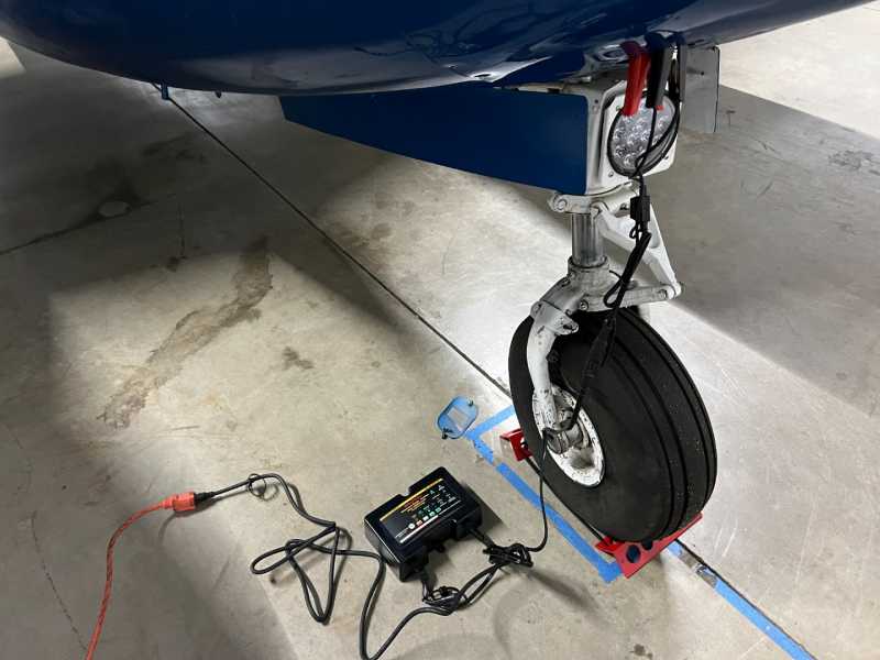

    On a good note; Santa brought me a BatteryMinder for my Apache’s Concorde battery. The battery charger is designed just for Concorde batteries and I hope it will help my battery have a much longer life than the previous two batteries. Thanks Santa!
    The charger attaches to the GPU port.
    Lots of info on the charger and I like knowing what it’s doing.

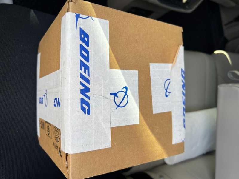

    Of course as soon as my mechanic leaves town the awaited part shows up on my doorstep.
    I never got a box that said “Boeing” before but it looks impressive!
    The part that was sent has yet ANOTHER part number on it that I am checking. My mechanic says it LOOKS like the correct part so we’ll see. At this point I’m ready just to stick this microswitch in and call it good but I really do want everything to work properly.

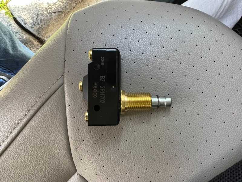

    A new “mini-disaster” for the Apache. We knew we had to replace the lighting rheostat and we have that about half done. However, on the test flight we had a random gear unsafe horn. So after finishing flying we checked the horn. Turns out we have a bad microswitch on the nosegear. Trying to locate one now (over Thanksgiving weekend!). If we don’t get it by Tuesday my mechanic is out of town for two weeks and obviously I am planning some flying during that time period. So….
    If anyone knows who I could contact for an Apache nosegear microswitch part # BZ-7RQ31T1 I appreciate it!
    *edit* I was able to get ahold of SkyGeek and they provided an alternate part number of SGP-45801 and they have them in stock. So I hope we can cancel the emergency! Also, I asked my mechanic to see if the extra gear leg I have as a salvage that came with the plane has a microswitch that matches. He is checking on that.
    *2nd edit* Salvage part wasn’t going to work. So we have ordered part from SkyGeek. Hopefully we can get this done before mechanic goes to Florida. We are still working on the rheostat.

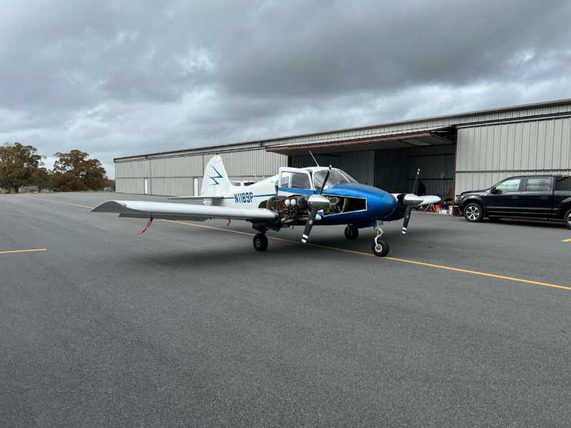

    Checking plane over after first pattern.
    Happy to have a plane flying again! My buddy will be getting his 182RG flying in the next month or two. His plane has been down 2 years as he has rebuilt the entire interior. (edit: I have no idea why the pic is upsidedown. No, we didn’t do aerobatics!)

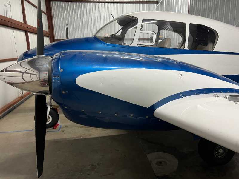

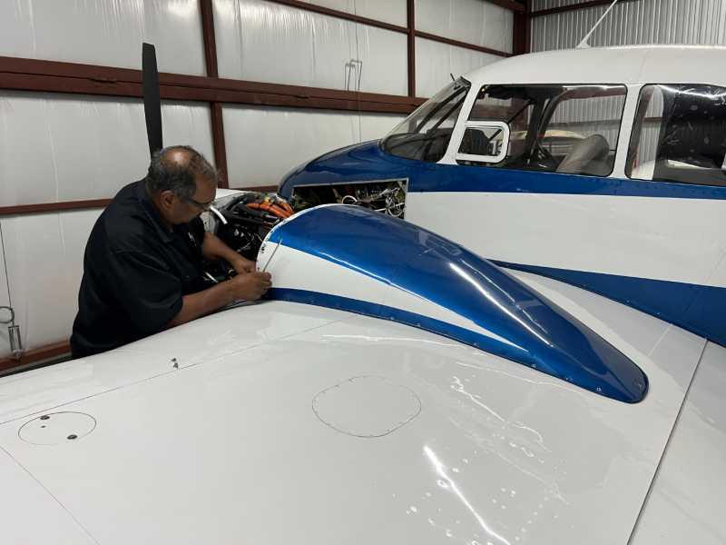

    More Apache “fun” today. We are in reassembly mode. Which on an Apache means LOTS of screws to put the engine nacelles back together!
    We finished the last of the work on the left engine and began “wrapping it up”. I tend to forget how many screws hold the nacelle together. I wish I had the contract to supply Piper with screws!

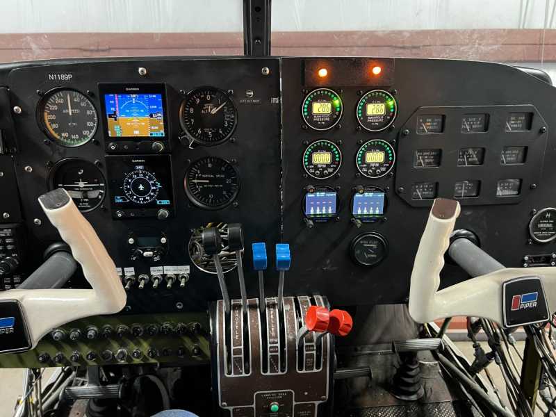

    We got the ALT OUT lights moved and working. We had a little trouble with locating them so the right one is slightly off center. However, when viewed from the left seat it looks right on! We had to add a plastic “spacer” to make the lights fit where we wanted them. We still have the cosmetic stuff to do such as paint and labels.
    If I’m very careful with my angle it almost looks completed. We still have the right side to go.
    After we finish this we still have a few things to do but the plane is now flyable once we finish getting the nacelles put back on.

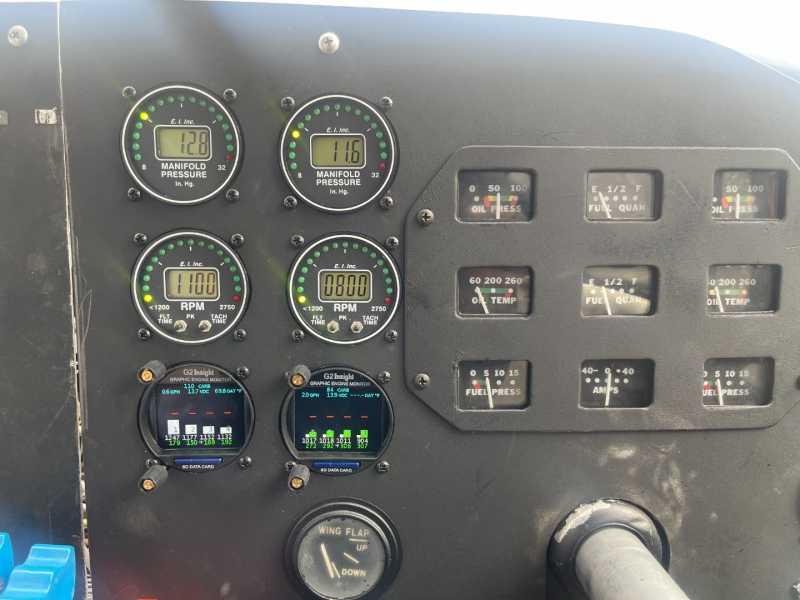

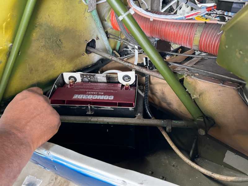

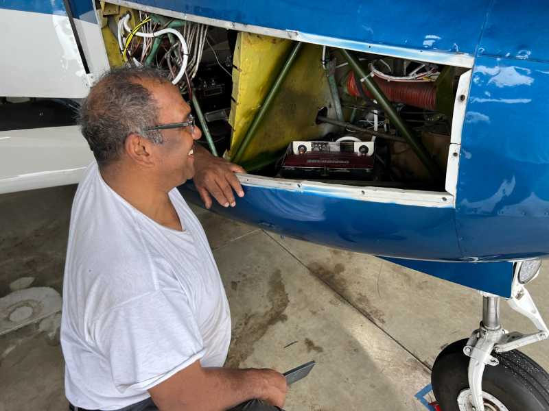

    We got all the new digital gauges working! It looks great to see them light up. I am very excited to try out the new Insight G2 GEM’s.
    The battery box was already upgraded and we just finished the last of the Bogert cable upgrades, We will be putting new copper cable from the GPU plug as well and that will give us all new copper cables.
    We put in a brand new Concorde battery as the old one just died on us. I think a combination of sitting in the hangar, occasional engine runs with little charging time and a trickle charger not optimized for the battery caused the old one to die,
    Nice to get the plane out again today and start it on it’s own power! We found the issue with no oil pressure indication on the left engine. It was a little bit of air in the line. Once that was “bled” it worked fine. Mag switches were turned around and now work as they should with up being “on”.
